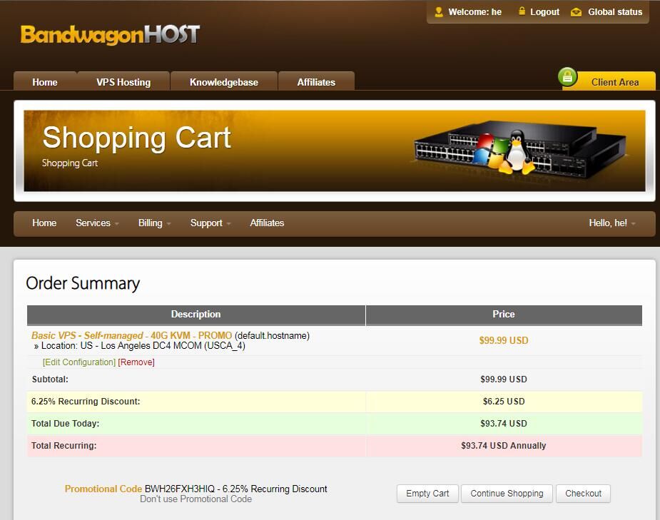

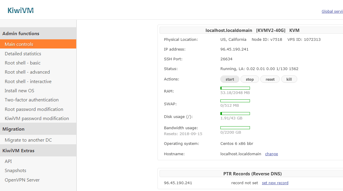

习惯了在vps上面编译代码,又买了一个40G ssd/2G RAM/3x Intel Xeon 搬瓦工vps(运行远程桌面,可以Qt编程)

我的还好,从来没有封过, 而且 年付19.9$以上(不包括) 都可以支持换IP.
直接网页操作,不是人工的.

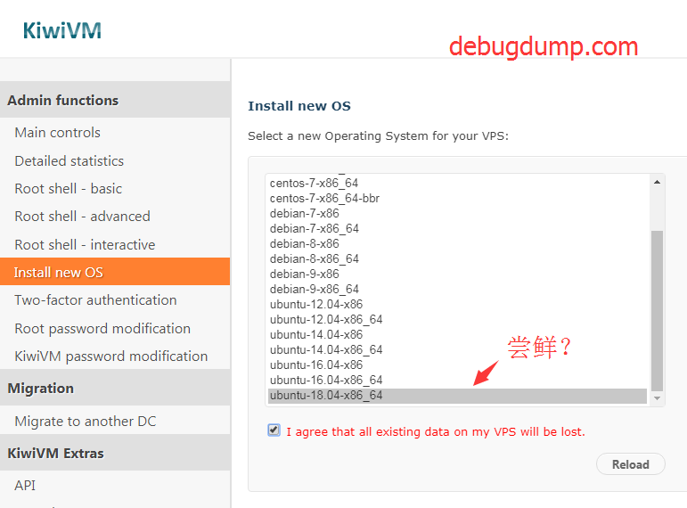

楼主 #4 2018-08-14 18:17:00
已发帖子: 9,473
Re: 习惯了在vps上面编译代码,又买了一个40G ssd/2G RAM/3x Intel Xeon 搬瓦工vps(运行远程桌面,可以Qt编程)
先装上 18.04 发现编译 f1c100s sdk有点问题,
马上重新安装上 16.04,
https://whycan.cn/t_1014.html
按这个一步一步,
三下五除二编译成功

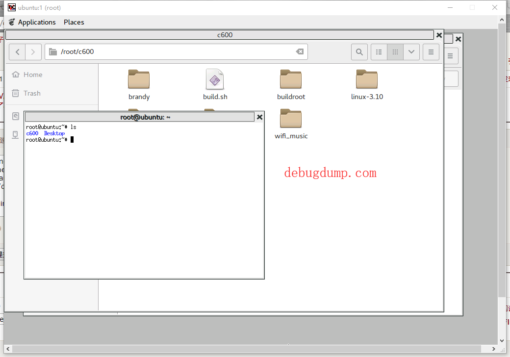

无聊试了一下远程桌面
安装 vncserver:
sudo apt-get install -y vnc4server
sudo apt-get install -y gnome-session-flashback
sudo apt-get install -y gnome-terminal
运行vncserver:
root@ubuntu:~# vncserver
New 'ubuntu:1 (root)' desktop is ubuntu:1
Starting applications specified in /root/.vnc/xstartup
Log file is /root/.vnc/ubuntu:1.log
https://askubuntu.com/questions/800302/vncserver-grey-screen-ubuntu-16-04-lts
修改 ~/.vnc/xstartup
Uncomment the following two lines for normal desktop:
unset SESSION_MANAGER
exec /etc/X11/xinit/xinitrc
[ -x /etc/vnc/xstartup ] && exec /etc/vnc/xstartup
[ -r $HOME/.Xresources ] && xrdb $HOME/.Xresources
xsetroot -solid grey
vncconfig -iconic &
x-terminal-emulator -geometry 80x24+10+10 -ls -title "$VNCDESKTOP Desktop" &
x-window-manager &
gnome-terminal &
gnome-panel &
gnome-settings-daemon &
metacity &
nautilus &
最后记得执行:
chmod +x ~/.vnc/xstartup
windows客户端连接:

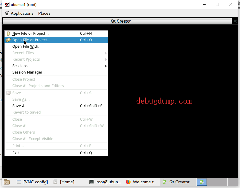

楼主 #8 2018-08-14 22:38:24
已发帖子: 9,473

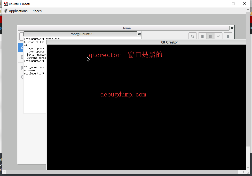

root@ubuntu:~# qtcreator
QXcbConnection: Failed to initialize XRandr
Qt: XKEYBOARD extension not present on the X server.
Cannot start '/root': Permission denied
Unsupported screen format: depth: 16, red_mask: 3f, blue_mask: f800
Using RGB16 fallback, if this works your X11 server is reporting a bad screen format.
QQuickWidget: Failed to make context current
QQuickWidget::resizeEvent() no OpenGL context
QQuickWidget: Cannot render due to failing makeCurrent()
QOpenGLShaderProgram: could not create shader program
QOpenGLShader: could not create shader
bool QOpenGLTextureBlitter::create() Could not link shader program:
QXcbConnection: XCB error: 157 (Unknown), sequence: 326, resource id: 1, major code: 148 (Unknown), minor code: 1
QXcbConnection: XCB error: 157 (Unknown), sequence: 328, resource id: 4, major code: 148 (Unknown), minor code: 1
QXcbConnection: XCB error: 157 (Unknown), sequence: 337, resource id: 1, major code: 148 (Unknown), minor code: 1
QXcbConnection: XCB error: 157 (Unknown), sequence: 339, resource id: 4, major code: 148 (Unknown), minor code: 1
QXcbConnection: XCB error: 157 (Unknown), sequence: 348, resource id: 1, major code: 148 (Unknown), minor code: 1
QXcbConnection: XCB error: 157 (Unknown), sequence: 350, resource id: 4, major code: 148 (Unknown), minor code: 1
QXcbConnection: XCB error: 157 (Unknown), sequence: 359, resource id: 1, major code: 148 (Unknown), minor code: 1
QXcbConnection: XCB error: 157 (Unknown), sequence: 374, resource id: 4, major code: 148 (Unknown), minor code: 1
QXcbConnection: XCB error: 157 (Unknown), sequence: 383, resource id: 1, major code: 148 (Unknown), minor code: 1
QXcbConnection: XCB error: 157 (Unknown), sequence: 385, resource id: 4, major code: 148 (Unknown), minor code: 1
QXcbConnection: XCB error: 157 (Unknown), sequence: 394, resource id: 1, major code: 148 (Unknown), minor code: 1
QXcbConnection: XCB error: 157 (Unknown), sequence: 396, resource id: 4, major code: 148 (Unknown), minor code: 1

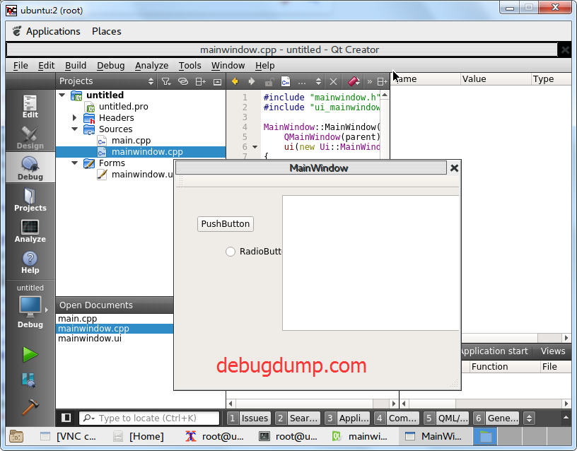

qtcreator 窗口全黑,log信息在上面.
楼主 #9 2018-08-14 22:58:42
已发帖子: 9,473

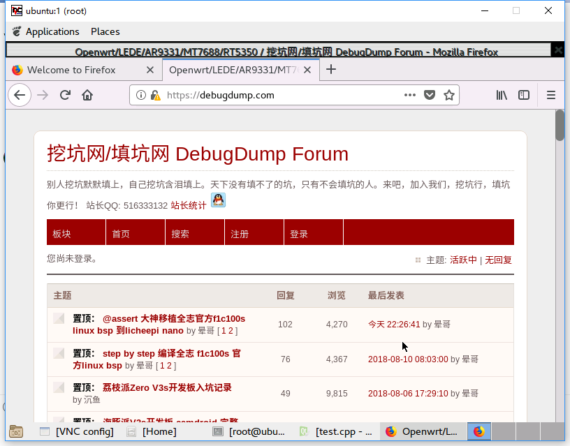

firefox 正常.
楼主 #10 2018-08-15 08:33:34
已发帖子: 9,473
这个问题找到解决方案了
参考: https://forum.selur.net/showthread.php?tid=55
命令行后加24参数:
vncserver -depth 24
楼主 #11 2018-08-15 08:49:20
已发帖子: 9,473
黑窗口找到一个治标的方法:
https://www.netsarang.com/forum/xmanager/4204/Cannot_Open_Qt_Creator_when_use_Xmanger_Enterprise_5
qt5/qtcreator 安装指令:
sudo apt-get install qt5-default qttools5-dev-tools qtcreator
启动运行:
qtcreator -noload Welcome
