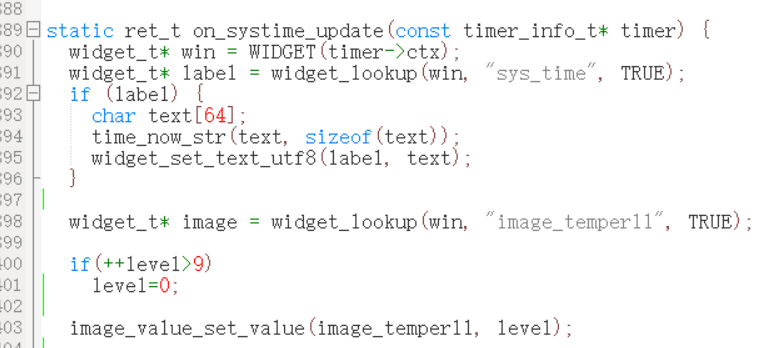

@lixianjing楼主大神,正在学习,想用自定义的数字图片,要用哪个控制来显示呢,我用image image_value label都试过了, 用了个timer,定义刷,或者2个按键+ 或-,在cb函数里面改变显示的图片,但没实现,求指点
代码类似这样
//widget_t* image_temper11 = image_value_create(win, 43, 74, 63, 80);
//image_value_set_image(image_temper11, "dig_");
//image_value_set_value(image_temper11, 3);
widget_t* image_temper11 = image_create(win, 43, 74, 63, 80);
image_set_image(image_temper11, "btn_1_manual");
image_set_draw_type(image_temper11, IMAGE_DRAW_DEFAULT); //IMAGE_DRAW_ICON
timer_add(on_systime_update, win, 2000);
static ret_t on_systime_update(const timer_info_t* timer) {
widget_t* image = widget_lookup(win, "image_temper11", TRUE);
if(++level>9)
level=9;
image_set_image(image_temper11, "dig_6");
//image_value_set_value(image_temper11, level);
return RET_REPEAT;
楼主 #45 2019-10-31 13:55:28

image_value应该可以啊。遇到什么问题?

定时刷,图片不会更新,只会显示初始化时候的那张图,后面定时动态更新图片,不会变化,但我猎取系统时间显示是ok的

我测试没问题啊,你参考一下:https://github.com/zlgopen/awtk-c-demos/blob/master/demos/image_value.c
你设置控件的名称了吗?上面的代码没看到。设置名称之后才能用widget_lookup查找:
widget_set_name(image_value, "image_temper11");

谢谢大神,参照demo已经弄好了,label, image_value都行了
