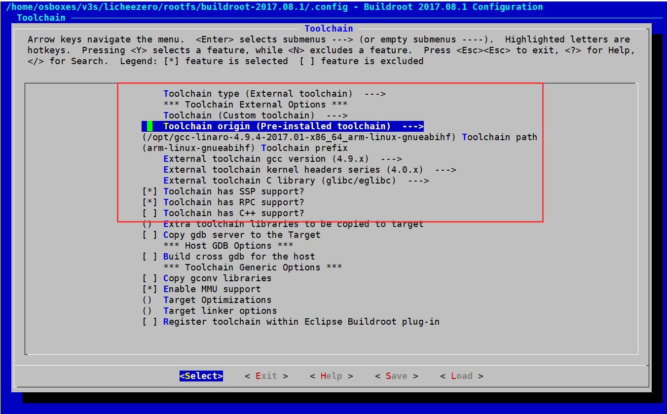

  4. 编译文件系统
    使用https://buildroot.org/downloads/buildroot-2017.08.1.tar.gz
    Toolchain
x x Toolchain type (External toolchain) ---> x x
x x Toolchain External Options x x
x x Toolchain (Custom toolchain) ---> x x
x x Toolchain origin (Pre-installed toolchain) ---> x x
x x (/opt/gcc-linaro-4.9.4-2017.01-x86_64_arm-linux-gnueabihf) Toolchain path
x x
x x (arm-linux-gnueabihf) Toolchain prefix x x
x x External toolchain gcc version (4.9.x) ---> x x
x x External toolchain kernel headers series (4.0.x) --->
x x
x x External toolchain C library (glibc/eglibc) ---> x x
Filesystem images 制作rootfs.cpio.gz
x x * cpio the root filesystem (for use as an initial RAM filesystem) x x
x x Compression method (gzip) --->
编译完成后,生成output/images/文件夹下的rootfs.cpio.gz

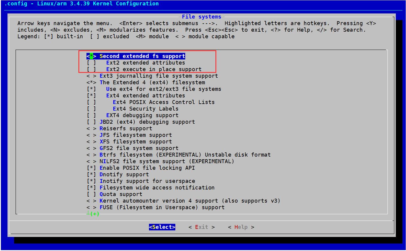

  1. 编译内核
    cp lichee_BSP_config .config
    配置内核
General setup --->
x x * Initial RAM filesystem and RAM disk (initramfs/initrd) support x x
x x (/home/osboxes/v3s/licheezero/rootfs/rootfs-bin) Initramfs source file(s)
x x (0) User ID to map to 0 (user root) x x
x x (0) Group ID to map to 0 (group root) x x
x x * Support initial ramdisks compressed using gzip x x
x x [ ] Support initial ramdisks compressed using bzip2 x x
x x [ ] Support initial ramdisks compressed using LZMA x x
x x [ ] Support initial ramdisks compressed using XZ x x
x x [ ] Support initial ramdisks compressed using LZO x x
x x Built-in initramfs compression mode (None) --->
其中/home/osboxes/v3s/licheezero/rootfs/rootfs-bin目录下存放制作好的rootfs.cpio.gz
make ARCH=arm CROSS_COMPILE=arm-linux-gnueabihf- uImage -j8

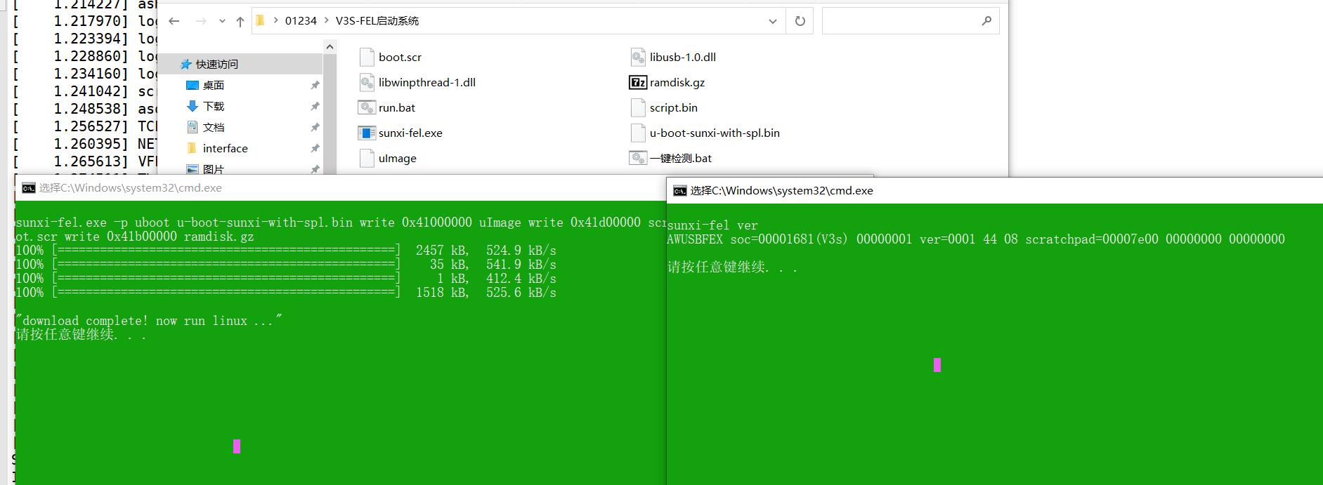

上电进入FEL模式运行:
sunxi-fel.exe -p uboot u-boot-sunxi-with-spl.bin write 0x41000000 uImage write 0x41d00000 script.bin write 0x41e00000 boot.scr write 0x41A00000 rootfs.cpio.gz.uImage
系统启动后停在
[ 1.324816] Warning: unable to open an initial console.
[ 1.330947] Waiting for root device /dev/ram0...
输入回车没有反应。

1. 让BSP从ramdisk根文件系统启动
1.1 修改内核配置选项
make ARCH=arm menuconfig
打开配置菜单,修改配置项
Ramdisk方式需要清空Initramfs source file(s)
*之所以(4096)是因为我之后制作的ramdisk是4096KB大小的。
如果这个大小和你做的ramdisk不匹配,则启动时仍然会出现 kernel panic,提示ramdisk格式不正确,挂载不上ramdisk。*
注意:ramdisk是一种内存虚拟磁盘技术,实质上并不是一种文件系统,它使用的文件系统是ext2文件系统。
1.2 文件系统配置
其中Toolchain path是kernel的交叉编译链的位置
kernel的版本,在交叉编译链下面查看:
libc/usr/include/linux/version.h
我这里的 LINUX_VERSION_CODE 版本是 262144
将262144转换16进制40000
我的编译链版本是4.0.0
保存配置开始编译
编译完成后生成根文件系统

完整BSP系统FEL启动包
生成
V3S-FEL启动系统.7z
