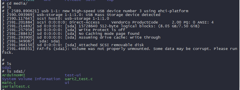

#6 全志 SOC » V3s linux5.2 U盘自动挂载配置 » 2021-06-23 18:16:44
hanzixi_angel
回复: 5
1.内核中usb相关配置:
USB support                                                            │ │
  │ │     <*>   Support for Host-side USB
  │ │     <*>   EHCI HCD (USB 2.0) support
  │ │     <*>     Generic EHCI driver for a platform device                          │ │
  │ │     <*>   OXU210HP HCD support                                                 │ │
  │ │     <*>   ISP116X HCD support                                                  │ │
  │ │     <*>   FOTG210 HCD support                                                  │ │
  │ │     < >   MAX3421 HCD (USB-over-SPI) support                                   │ │
  │ │     <*>   OHCI HCD (USB 1.1) support                                           │ │
  │ │     <*>     Generic OHCI driver for a platform device                          │ │
  │ │     <*>   SL811HS HCD support
  │ │     <*>   USB Mass Storage support
2.USB热插拔配置:
 > Device Drivers > Generic Driver Options >Generic Driver Options
  │ │     [ * ] Support for uevent helper
打开之后会出现/proc/sys/kernel/hotplug设备,可解决hotplug不存在的问题 ;
3.buildroot中busybox有关mdev配置
buildroot中执行如下命令
#make busybox-menuconfig
选择
Linux System Utilities --->
             [ * ]mdev
             [ * ]     Support /etc/mdev.conf
             [ * ]          Support subdirs/symlinks
             [ * ]               Support regular expressions substitutions when renaming device
             [ * ]          Support command execution at device addition/removal
             [ * ]     Support loading of firmwares
  1. /etc/init.d/rcS中增加如下配置
    echo /sbin/mdev > /proc/sys/kernel/hotplug
    5.在/etc/下建立mdev.conf的文件,添加如下配置:
sd[a-z][0-9]      0:0 666        @(/etc/hotplug/insert.sh $MDEV $SUBSYSTEM)
sd[a-z]           0:0 666        $(/etc/hotplug/remove.sh $MDEV $SUBSYSTEM)
ub[a-z][0-9]      0:0 666        @(/etc/hotplug/insert.sh $MDEV $SUBSYSTEM)
ub[a-z]           0:0 666        $(/etc/hotplug/remove.sh $MDEV $SUBSYSTEM)
mmcblk[0-9]p[0-9] 0:0 666        @(/etc/hotplug/insert.sh $MDEV $SUBSYSTEM)
mmcblk[0-9]       0:0 666        $(/etc/hotplug/remove.sh $MDEV $SUBSYSTEM)
6.在/etc/下建立以下文件夹hotplug,并在hotplug目录下建立insert.sh和remove.sh文件,并填下如下脚本文件:
insert.sh:
 if [ -n "$1" ] ; then
     if [ -b /dev/$1 ]; then
         if [ ! -d /media ]; then
             mkdir -p /media
         fi
         if [ ! -d /media/$1 ]; then
             mkdir -p /media/$1
         fi
              mount /dev/$1 /media/$1
 if [ $? -ne 0 ]; then
     rm -rf /media/$1
         fi
     fi
 fi
remove.sh:
 MOUNTS=$(mount | grep $1 | cut -d' ' -f3)
 umount $MOUNTS
 rm -rf $MOUNTS
重启设备,插入U盘可以自动挂载到/media目录,亲测可正常挂载和卸载;
挂载:
卸载:

#57 Re: 全志 SOC » V3s/S3/f1c100s通过USB启动Linux,并把SD NAND/TF卡挂载为U盘, 可以dd或Win32DiskImager任烧写 » 2020-09-22 11:07:15
启动之后无法挂载sd nand到pc 看不到是哪的问题 能帮忙分析一下嘛 信息
usb id引脚在dts是怎么配置的?
晕哥 我不是很明白 我使用的是您提供的sun8i-v3s-licheepi-zero-dock.dtb.PF6 这个跟dts啥关系 是跟我是设备树dts文件有关系嘛 这个不是从usb启动的嘛 如果是要修改我的dts该如何修改? 谢谢
#58 Re: 全志 SOC » V3s/S3/f1c100s通过USB启动Linux,并把SD NAND/TF卡挂载为U盘, 可以dd或Win32DiskImager任烧写 » 2020-09-21 17:53:34

# [  215.284394] random: crng init done
晕哥 启动之后无法挂载sd nand到pc 看不到是哪的问题 能帮忙分析一下嘛 信息
