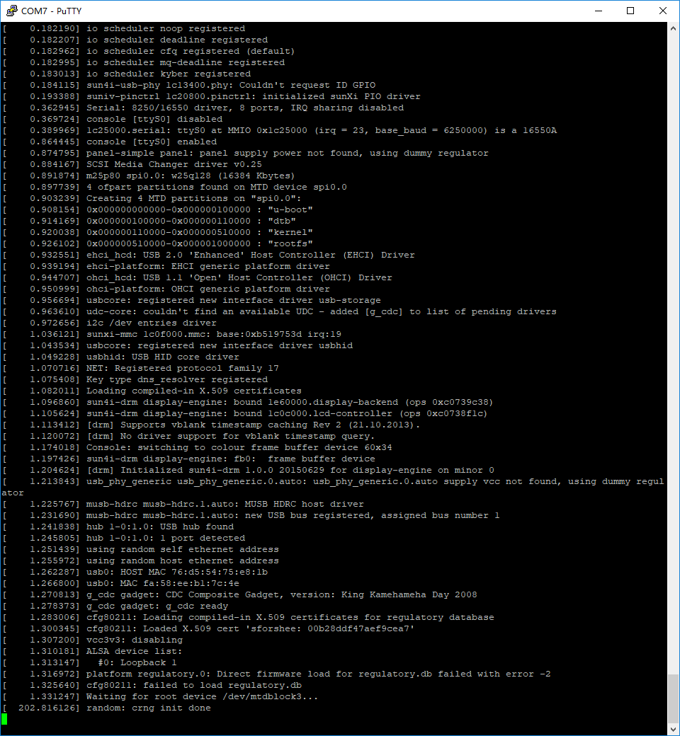

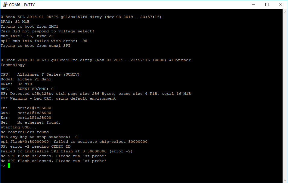

MMC:   SUNXI SD/MMC: 0
SF: Detected w25q128 with page size 256 Bytes, erase size 4 KiB, total 16 MiB
In:    serial@1c25000
Out:   serial@1c25000
Err:   serial@1c25000
Net:   No ethernet found.
starting USB...
No controllers found
   Loading Device Tree to 80e05000, end 80e0a3b5 ... OK
[    0.000000] Linux version 5.2.0-licheepi-nano+ (zjf@book-virtual-machine) (gcc version 7.2.1 20171011 (Linaro GCC 7.2-2017.11)) #10 Mon May 18 01:03:16 CST 2020
[    0.000000] Kernel command line: console=ttyS0,115200 panic=5 rootwait root=/dev/mtdblock3 rw rootfstype=jffs2
[    0.000000] Memory: 22696K/32768K available (6144K kernel code, 233K rwdata, 1472K rodata, 1024K init, 228K bss, 10072K reserved, 0K cma-reserved, 0K highmem)

[    0.227429] suniv-f1c100s-pinctrl 1c20800.pinctrl: initialized sunXi PIO driver
[    0.421545] Serial: 8250/16550 driver, 8 ports, IRQ sharing disabled
[    0.427394] suniv-f1c100s-pinctrl 1c20800.pinctrl: 1c20800.pinctrl supply vcc-pe not found, using dummy regulator
[    0.429331] printk: console [ttyS0] disabled
[    0.449598] 1c25000.serial: ttyS0 at MMIO 0x1c25000 (irq = 25, base_baud = 6250000) is a 16550A
[    0.829064] printk: console [ttyS0] enabled
[    0.837489] suniv-f1c100s-pinctrl 1c20800.pinctrl: 1c20800.pinctrl supply vcc-pd not found, using dummy regulator
[    0.889606] brd: module loaded
[    0.913898] loop: module loaded
[    0.918114] SCSI Media Changer driver v0.25
[    0.923707] suniv-f1c100s-pinctrl 1c20800.pinctrl: 1c20800.pinctrl supply vcc-pc not found, using dummy regulator
[    0.936693] m25p80 spi0.0: w25q128 (16384 Kbytes)
[    0.942461] 4 fixed-partitions partitions found on MTD device spi0.0
[    0.948941] Creating 4 MTD partitions on "spi0.0":
[    0.953754] 0x000000000000-0x000000100000 : "u-boot"
[    0.962681] 0x000000100000-0x000000110000 : "dtb"
[    0.971157] 0x000000110000-0x000000510000 : "kernel"
[    0.979945] 0x000000510000-0x000001000000 : "rootfs"

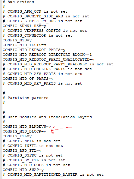

[    1.331966] VFS: Cannot open root device "mtdblock3" or unknown-block(31,3): error -19
[    1.340000] Please append a correct "root=" boot option; here are the available partitions:
[    1.348483] 0100            4096 ram0
[    1.348493]  (driver?)
[    1.354603] 0101            4096 ram1
[    1.354607]  (driver?)
[    1.360782] 0102            4096 ram2
[    1.360788]  (driver?)
[    1.366930] 0103            4096 ram3
[    1.366936]  (driver?)
[    1.373097] 0104            4096 ram4
[    1.373104]  (driver?)
[    1.379281] 0105            4096 ram5
[    1.379288]  (driver?)
[    1.385390] 0106            4096 ram6
[    1.385395]  (driver?)
[    1.391552] 0107            4096 ram7
[    1.391557]  (driver?)
[    1.397725] 0108            4096 ram8
[    1.397733]  (driver?)
[    1.403834] 0109            4096 ram9
[    1.403838]  (driver?)
[    1.410010] 010a            4096 ram10
[    1.410017]  (driver?)
[    1.416240] 010b            4096 ram11
[    1.416246]  (driver?)
[    1.422489] 010c            4096 ram12
[    1.422495]  (driver?)
[    1.428728] 010d            4096 ram13
[    1.428735]  (driver?)
[    1.434952] 010e            4096 ram14
[    1.434958]  (driver?)
[    1.441203] 010f            4096 ram15
[    1.441210]  (driver?)
[    1.447434] 1f00            1024 mtdblock0
[    1.447441]  (driver?)
[    1.454031] 1f01              64 mtdblock1
[    1.454037]  (driver?)
[    1.460617] 1f02            4096 mtdblock2
[    1.460622]  (driver?)
[    1.467188] 1f03           11200 mtdblock3
[    1.467194]  (driver?)
[    1.473780] Kernel panic - not syncing: VFS: Unable to mount root fs on unknown-block(31,3)
[    1.482120] CPU: 0 PID: 1 Comm: swapper Not tainted 5.2.0-licheepi-nano+ #10
[    1.489147] Hardware name: Allwinner suniv Family
[    1.493902] [<c010e478>] (unwind_backtrace) from [<c010ba5c>] (show_stack+0x10/0x14)
[    1.501647] [<c010ba5c>] (show_stack) from [<c0116db4>] (panic+0xe8/0x2e4)
[    1.508529] [<c0116db4>] (panic) from [<c090129c>] (mount_block_root+0x1ec/0x2e0)
[    1.516006] [<c090129c>] (mount_block_root) from [<c09016bc>] (prepare_namespace+0x158/0x1b8)
[    1.524536] [<c09016bc>] (prepare_namespace) from [<c065a670>] (kernel_init+0x8/0x110)
[    1.532452] [<c065a670>] (kernel_init) from [<c01010e0>] (ret_from_fork+0x14/0x34)
[    1.540000] Exception stack(0xc1831fb0 to 0xc1831ff8)
[    1.545051] 1fa0:                                     00000000 00000000 00000000 00000000
[    1.553218] 1fc0: 00000000 00000000 00000000 00000000 00000000 00000000 00000000 00000000
[    1.561382] 1fe0: 00000000 00000000 00000000 00000000 00000013 00000000
[    1.567993] Rebooting in 5 seconds..
[    7.547227] Reboot failed -- System halted
博主好,请问我这个好像是没有识别到mtd这个是啥原因,MTD有打开的
CONFIG_MTD_BLKDEVS=y
CONFIG_MTD_BLOCK=y
CONFIG_FTL=y
CONFIG_RFD_FTL=y
CONFIG_MTD_SWAP=y
#212 2020-05-18 08:54:40
已发帖子: 3,403
积分: 1907
Re: 尝试从零构建F1C100s开发环境
可能没有开jffs2文件系统
可能 mtd3 上没有合法的jffs2文件系统。
第一种原因可能性大一些。
在线
楼主 #213 2020-05-18 10:22:01
LinjieGuo
注册时间: 2019-07-24
已发帖子: 592
积分: 595
In:    serial@1c25000
Out:   serial@1c25000
Err:   serial@1c25000
starting USB...
[    0.000000] random: get_random_bytes called from start_kernel+0x254/0x42c with crng_init=0
[    0.000047] sched_clock: 32 bits at 24MHz, resolution 41ns, wraps every 89478484971ns
[    0.000127] clocksource: timer: mask: 0xffffffff max_cycles: 0xffffffff, max_idle_ns: 79635851949 ns
[    0.000709] Console: colour dummy device 80x30
[    0.000807] Calibrating delay loop... 203.16 BogoMIPS (lpj=1015808)
[    0.070245] pid_max: default: 32768 minimum: 301
[    0.070674] Mount-cache hash table entries: 1024 (order: 0, 4096 bytes)
[    0.070714] Mountpoint-cache hash table entries: 1024 (order: 0, 4096 bytes)
[    0.072400] CPU: Testing write buffer coherency: ok
[    0.074424] Setting up static identity map for 0x80100000 - 0x80100058
[    0.076719] devtmpfs: initialized
[    0.084396] clocksource: jiffies: mask: 0xffffffff max_cycles: 0xffffffff, max_idle_ns: 19112604462750000 ns
[    0.084457] futex hash table entries: 256 (order: -1, 3072 bytes)
[    0.084767] pinctrl core: initialized pinctrl subsystem
[    0.086849] NET: Registered protocol family 16
[    0.088278] DMA: preallocated 256 KiB pool for atomic coherent allocations
[    0.090494] cpuidle: using governor menu
[    0.144032] SCSI subsystem initialized
[    0.144444] usbcore: registered new interface driver usbfs
[    0.144604] usbcore: registered new interface driver hub
[    0.144792] usbcore: registered new device driver usb
[    0.145298] pps_core: LinuxPPS API ver. 1 registered
[    0.145324] pps_core: Software ver. 5.3.6 - Copyright 2005-2007 Rodolfo Giometti <giometti@linux.it>
[    0.145850] Advanced Linux Sound Architecture Driver Initialized.
[    0.147573] clocksource: Switched to clocksource timer
[    0.178726] NET: Registered protocol family 2
[    0.180294] tcp_listen_portaddr_hash hash table entries: 512 (order: 0, 4096 bytes)
[    0.180374] TCP established hash table entries: 1024 (order: 0, 4096 bytes)
[    0.180435] TCP bind hash table entries: 1024 (order: 0, 4096 bytes)
[    0.180483] TCP: Hash tables configured (established 1024 bind 1024)
[    0.180774] UDP hash table entries: 256 (order: 0, 4096 bytes)
[    0.180835] UDP-Lite hash table entries: 256 (order: 0, 4096 bytes)
[    0.181346] NET: Registered protocol family 1
[    0.183860] NetWinder Floating Point Emulator V0.97 (double precision)
[    0.186019] Initialise system trusted keyrings
[    0.186614] workingset: timestamp_bits=30 max_order=13 bucket_order=0
[    0.207933] squashfs: version 4.0 (2009/01/31) Phillip Lougher
[    0.214559] Key type asymmetric registered
[    0.214596] Asymmetric key parser 'x509' registered
[    0.214781] Block layer SCSI generic (bsg) driver version 0.4 loaded (major 252)
[    0.214808] io scheduler mq-deadline registered
[    0.214825] io scheduler kyber registered
[    0.989196] ehci_hcd: USB 2.0 'Enhanced' Host Controller (EHCI) Driver
[    0.995727] ehci-platform: EHCI generic platform driver
[    1.001387] ohci_hcd: USB 1.1 'Open' Host Controller (OHCI) Driver
[    1.007714] ohci-platform: OHCI generic platform driver
[    1.013380] usbcore: registered new interface driver usb-storage
[    1.021215] input: 1c23400.lradc as /devices/platform/soc/1c23400.lradc/input/input0
[    1.030119] i2c /dev entries driver
[    1.037778] suniv-f1c100s-pinctrl 1c20800.pinctrl: 1c20800.pinctrl supply vcc-pf not found, using dummy regulator
[    1.075933] sunxi-mmc 1c0f000.mmc: initialized, max. request size: 16384 KB
[    1.085407] usbcore: registered new interface driver usbhid
[    1.091109] usbhid: USB HID core driver
[    1.111993] NET: Registered protocol family 17
[    1.116556] Key type dns_resolver registered
[    1.123402] Loading compiled-in X.509 certificates
[    1.138698] suniv-f1c100s-pinctrl 1c20800.pinctrl: 1c20800.pinctrl supply vcc-pd not found, using dummy regulator
[    1.150125] sun4i-backend 1e60000.display-backend: Couldn't find matching frontend, frontend features disabled
[    1.160956] sun4i-drm display-engine: bound 1e60000.display-backend (ops 0xc0738094)
[    1.170036] sun4i-drm display-engine: bound 1c0c000.lcd-controller (ops 0xc0736cec)
[    1.177818] [drm] Supports vblank timestamp caching Rev 2 (21.10.2013).
[    1.184421] [drm] No driver support for vblank timestamp query.
[    1.191734] [drm] Initialized sun4i-drm 1.0.0 20150629 for display-engine on minor 0
[    1.249948] Console: switching to colour frame buffer device 60x34
[    1.273157] sun4i-drm display-engine: fb0: sun4i-drmdrmfb frame buffer device
[    1.281268] cfg80211: Loading compiled-in X.509 certificates for regulatory database
[    1.299447] cfg80211: Loaded X.509 cert 'sforshee: 00b28ddf47aef9cea7'
[    1.306225] vcc5v0: disabling
[    1.309331] ALSA device list:
[    1.312362]   #0: Loopback 1
[    1.316260] platform regulatory.0: Direct firmware load for regulatory.db failed with error -2
[    1.324988] cfg80211: failed to load regulatory.db
CONFIG_MTD_BLOCK=y
CONFIG_FTL=y
CONFIG_RFD_FTL=y
CONFIG_MTD_SWAP=y

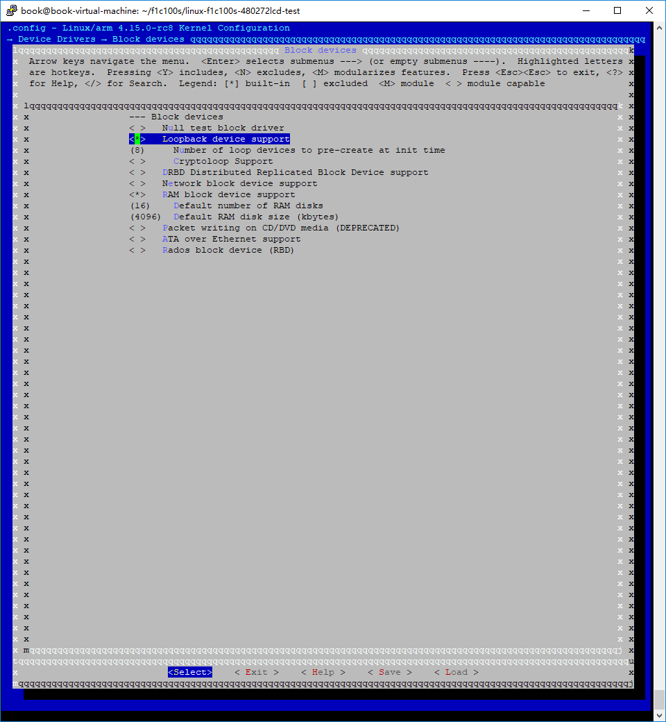

试一下这个:
观察启动log,发现,卡住的地方,有一条记录: #0: Loopback 1
再次进入配置界面:make ARCH=arm menuconfig
Device Drivers --->Block devices --->
[v]Loopback device support,勾选,看到其他有的选项,也勾上吧,相信也无妨......
上门有这个错误记录,回去看看。不知道是否为这个原因。
最近编辑记录 LinjieGuo (2020-05-18 10:22:55)

请问具体是哪里出问题了,我现在也遇到了同样的问题,并且串口输出与你的一摸一样。实在是不明白哪里错了。
最近编辑记录 Natural (2020-05-29 22:43:55)
#230 2020-05-30 10:47:35
Natural
注册时间: 2020-05-28
找到问题了,我重新梳理了一遍流程发现自己的flash不是w系列和en系列的(官网买的板子居然用了自家源代码不支持的flash,也可能是我用的代码比较老),是Xt25f128b的。查资料改代码解决的。

log打印 m25p80 spi0.0: w25q128 (16384 Kbytes)之后没有打印分区信息,最后卡在了Waiting for root device /dev/mtdblock3...请问这个怎么解决呢
回到15楼,不要着急,慢慢看。

LinjieGuo wrote:
回到15楼,不要着急,慢慢看。
论坛上好多方法我都试过了,都行不通,帖子里要修改的地方我都修改了,还是不打印分区信息。
楼主 #247 2020-06-10 09:08:57
LinjieGuo
注册时间: 2019-07-24
已发帖子: 592
积分: 595
可以直接下载我配置好的虚拟机,这个地方,有2个可能:{
①荔枝派的坑,一个":"引发的问题
②15楼,配置一下有"Loopback"字眼的项
最近编辑记录 LinjieGuo (2020-06-10 09:09:47)

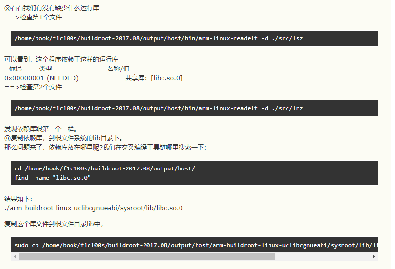

你用buildroot下面的工具链就没问题了: output/host/bin/arm-linux-gcc
换了这个工具链运行的时候显示段错误了,只是写了个helloworld
./hello
Segmentation fault
需要的动态库也移植了
wings@ubuntu:~/Lichee/opt$ ./compile.sh
NEEDED libc.so.0
不知道咋回事啊
./hello
Segmentation fault
需要的动态库也移植了
NEEDED libc.so.0
不知道咋回事啊
使用buildroot里面的交叉编译工具链。参考这篇文章:
https://whycan.cn/t_4266.html

没有人遇到过flash芯片是xt25f128b的情况吗

这个问题已经解决了,就是一开始没想到会是这个问题,而且flash芯片上的字也看不清了,导致前期踩了一个大坑。在这里发个言提醒一下新来的人,如果官方包启动不了,可以考虑一下是不是flash芯片的问题。

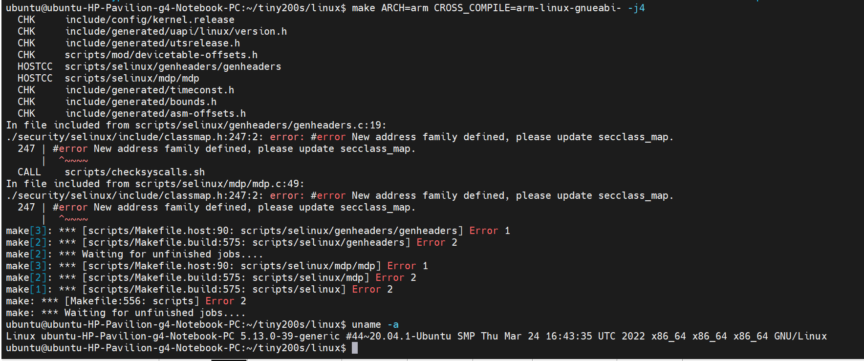

楼主:
我编译内核的时候会报错,
在ubuntu 和centos下都试过, 网上说更新ubuntu的内核到其他版本可以解决,试过好几个版本也都一样,你们编译没遇到这个问题吗?
make[1]: *** 正在等待未完成的任务....
In file included from ./include/linux/string.h:6:0,
from ./include/uapi/linux/uuid.h:22,
from ./include/linux/uuid.h:19,
from ./include/linux/mod_devicetable.h:13,
from scripts/mod/devicetable-offsets.c:3:
./include/linux/compiler.h:242:10: fatal error: asm/barrier.h: 没有那个文件或目录
#include <asm/barrier.h>
compilation terminated.
scripts/Makefile.build:150: recipe for target 'scripts/mod/devicetable-offsets.s' failed
make[2]: *** [scripts/mod/devicetable-offsets.s] Error 1

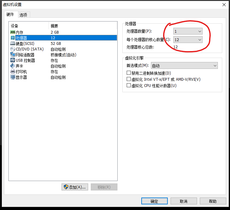

楼主 #297 2020-12-19 00:22:27
LinjieGuo
注册时间: 2019-07-24
已发帖子: 592
积分: 595
楼主 #298 2020-12-19 00:23:02
LinjieGuo
注册时间: 2019-07-24
已发帖子: 592
积分: 595
修改成你自己的cpu线程数就可以了

楼主 #300 2020-12-23 19:28:25
LinjieGuo
注册时间: 2019-07-24
已发帖子: 592
积分: 595
tang6397 wrote:
LinjieGuo暈哥
virtual machine setting-->hard ware-->processors-->
12cpu-->8cpu-->ok
open ubuntu 64.vmx-->Install Tools......
(PM 5:00-->10:00 )任务管理噐-->不允许, 12*cpu,
在VMWare里改没有用, 你的已配置环境work.zip移植不了.
看看是不是你的虚拟机软件版本问题呢,我使用得是很旧的VM 12Pro
#301 2020-12-24 15:55:07
tang6397
注册时间: 2020-06-27
已发帖子: 95
积分: 94.5
我的PC 惠普笔记本电脑 i5-8300H 8*2.3GHz
VMware-workstation-full-14.0.0.exe
ubuntu-14.04-desktop-amd64.iso
楼主 #302 2020-12-24 19:51:43
LinjieGuo
注册时间: 2019-07-24
已发帖子: 592
积分: 595
我明白你的意思了,因为我的是6核心12线程处理器,所以可以选择12个Core,你的不是,是不能这样选的。只能选择适合的Core数。

楼主 #311 2021-01-12 11:22:11
LinjieGuo
注册时间: 2019-07-24
已发帖子: 592
积分: 595
raspberryman wrote:
应该是是缺库,用静态链接,一般没有问题。
编译命令行加 -static 能不能跑?
如果是缺少库,参考这篇文章,把相关的库文件复制过来。
最近编辑记录 LinjieGuo (2021-01-12 11:22:41)

#319 2021-01-13 16:46:42
LinuxGo
注册时间: 2021-01-07
已发帖子: 88
积分: 120
你好 linjie
按步骤,到这里时下载进去后 启动 进不了系统,, 下面是信息,不知怎么办了
U-Boot SPL 2018.01-05679-g013ca457fd-dirty (Jan 13 2021 - 14:37:47)
DRAM: 32 MiB
Trying to boot from MMC1
mmc_init: -95, time 22
Trying to boot from sunxi SPI
U-Boot 2018.01-05679-g013ca457fd-dirty (Jan 13 2021 - 14:37:47 +0800) Allwinner Technology
CPU: Allwinner F Series (SUNIV)
Model: Lichee Pi Nano
DRAM: 32 MiB
SF: unrecognized JEDEC id bytes: 0b, 40, 18
In: serial@1c25000
Out: serial@1c25000
Err: serial@1c25000
starting USB...
No SPI flash selected. Please run `sf probe'
LinjieGuo wrote:
7 烧写验证
(1)参考文章:https://whycan.cn/t_444.html
编译、安装Windows版本sunxi-fel步骤 (32M spi flash补丁,支持W25Q256/MX25L256)
安装好驱动,烧写bin文件到单板上。
(2)观察串口输出:
/files/members/1845/log.png
明显是存在问题,但是不知道问题出在哪里,太晚了,只能先睡觉。

你好,linjie
目前我卡在这里,配置和你一样还是不行 ,,, 错误也一样。,,,
[ 1.372966] ALSA device list:
[ 1.375940] #0: Loopback 1
[ 1.379707] platform regulatory.0: Direct firmware load for regulatory.db failed with error -2
[ 1.388454] cfg80211: failed to load regulatory.db
[ 1.394132] Waiting for root device /dev/mtdblock3...
[ 202.722558] random: crng init done
LinjieGuo wrote:
编译完毕,打包后烧写bin文件。非常遗憾,结果依旧!
/files/members/1845/log3.png
观察.config里的配置项
/files/members/1845/config%E4%B8%ADMTD%E9%80%89%E9%A1%B9.png
文件中,可以看出,MTD_BLOCK已经配置为y,但依然没能成功启动。
我怀疑也许是根文件系统配置的问题。夜深了,明日继续。
算了,还是再搞搞把,这么早休息实在没劲,继续折腾。
[v]Loopback device support,勾选,看到其他有的选项,也勾上吧,相信也无妨,贴图:
/files/members/1845/DeviceDrivers__Blockdevices.png
保存配置,继续编译。
make ARCH=arm CROSS_COMPILE=arm-linux-gnueabi- -j4
打包后烧录验证。

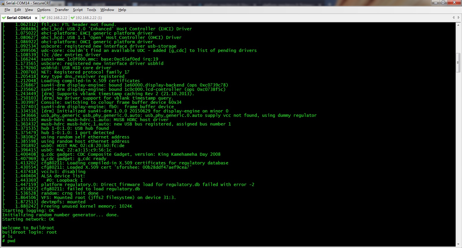

首先向楼主道个喜,哈!看了楼主的帖子 我终于进了系统。 谢谢!
其次:向后来人 指下路,,,板子上装 xt25f128 的flash 在这里要改成
原来 :
6.3 修改内核配置
(1)make ARCH=arm menuconfig
(2)勾选 File systems ‣ Miscellaneous filesystems ‣ Journalling Flash File System v2 (JFFS2) support
(3)修改源码下的 ./drivers/mtd/spi-nor.c
vi ./drivers/mtd/spi-nor/spi-nor.c
注释掉以下一行:
//{ "w25q128", INFO(0xef4018, 0, 64 * 1024, 256, SECT_4K) },
在这一行下面增加一项:
{ "w25q128", INFO(0xef4018, 0, 64 * 1024, 256, 0) },
注意这里:{ "w25q128", INFO(0xef4018, 0, 64 * 1024, 256, 0) }, 包括涉及到w25q128 的地方都改成 xt25f128 生成 红色文本
LinjieGuo wrote:
6 打包出烧写spi flash的bin文件

积分: 10.5
各位大佬能不能看下我这个是什么问题?现在买的荔枝派nano配的xt25f128,我应该配置好了,但是后续出现rfd_ftl: no RFD magic found in 'u-boot',还有VFS: Cannot open root device "(null)" or unknown-block(0,0): error -6,麻烦大佬帮我看看 LOG:log.txt
最近编辑记录 loopinnova (2021-04-04 23:27:58)
#342 2021-04-05 00:01:12
raspberryman
注册时间: 2019-12-27
已发帖子: 503
积分: 465
[ 0.952845] Creating 4 MTD partitions on "spi0.0":
[ 0.957800] 0x000000000000-0x000000100000 : "u-boot"
[ 0.966748] rfd_ftl: no RFD magic found in 'u-boot'
[ 0.973911] ftl_cs: FTL header not found.
[ 0.979699] 0x000000100000-0x000000210000 : "dtb"
[ 0.988407] rfd_ftl: no RFD magic found in 'dtb'
[ 0.995293] ftl_cs: FTL header not found.
[ 1.000986] 0x000000110000-0x000000620000 : "kernel"
[ 1.019761] rfd_ftl: no RFD magic found in 'kernel'
[ 1.027133] ftl_cs: FTL header not found.
[ 1.032773] 0x000000510000-0x000001000000 : "rootfs"
[ 1.066081] rfd_ftl: no RFD magic found in 'rootfs'
[ 1.073276] ftl_cs: FTL header not found.
奇怪,这是什么错误?
奇怪,这是什么错误?
我也不知道,要请教一下晕哥了

教程中的板载FLASH是w25q128,而我的flash是xt25f128b。一直跑不起来就是因为我的flash不在支持列表中,后在u-boot目录下./drivers/mtd/spi/spi_flash_ids.c中添加{"xt25f128b", INFO(0x0b4018, 0x0, 64 * 1024, 256, RD_FULL | WR_QPP | SECT_4K) },
在linux-f1c100s-480272lcd-test目录下修改./drivers/mtd/spi-nor/spi-nor.c文件,添加{ "xt25f128b", INFO(0x0b4018, 0, 64 * 1024, 256, 0) },
最后在./arch/arm/boot/dts/suniv-f1c100s-licheepi-nano.dts中修改
&spi0 {
flash@0 {
compatible = "winbond,xt25f128b", "jedec,spi-nor";
重编译后烧录,成功跑起!感谢此贴https://zhuanlan.zhihu.com/p/76221655?from_voters_page=true
@LinjieGuo 去掉冒号, 那个地方是荔枝派文档挖的大坑。
u-boot 的 bootcmd 里面 sf probe 0:500000
上面命令行的冒号。
绝了绝了,哈哈。后面的文档已经在改了。坑呀坑呀就习惯了,哈哈!

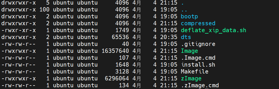

从lz的虚拟机中把linux源码拷贝到我的ubuntu中,编译就报错了:
#367 2022-04-04 20:04:35
已发帖子: 856
积分: 697
宿主内核系统api更新导致,把sys/socket.h改为linux/socket.h即可
最近编辑记录 kekemuyu (2022-04-04 20:05:24)
#368 2022-04-04 21:39:11
已发帖子: 856
积分: 697
同样的linux源码和配置文件,只是换了个宿主系统,内核编译出来体积翻倍。
