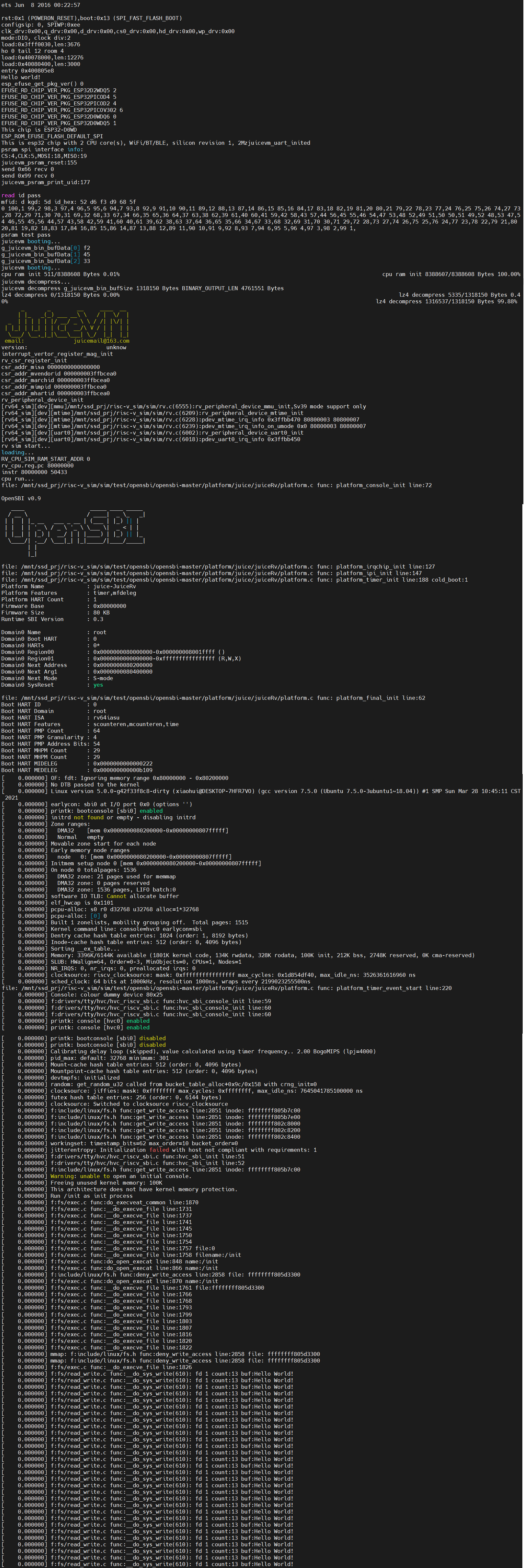

#1 Re: RISC-V » [juicevm] 只需要不到5000行代码实现一个risc-v虚拟机,纯c语言实现,无第三方库,支持ESP32 & GDB » 2024-03-28 17:40:13
juicevm的源代码真的没时间整理了。不嫌乱的话可以投票是否开源。
新项目,不过也是不怎么更新,但是开源: https://juicescript.com/
https://gitee.com/Li_XiongHui/juicescript

#19 Re: RISC-V » [juicevm] 只需要不到5000行代码实现一个risc-v虚拟机,纯c语言实现,无第三方库,支持ESP32 & GDB » 2021-11-10 15:23:03
2021-11-12更新:
1.在linux平台和window下支持模拟显示器。
juice_vm_release_9bf0c4eb2.zip
加速后的效果
 * Automatically generated file; DO NOT EDIT.
 * JuiceVm Compile Menu
#define CONFIG_HAVE_FB_SDL_SUPPORT 1
#define CONFIG_FB_SDL_HEIGHT 480
#define CONFIG_FB_SDL_WIDTH 600
 * Copyright (c) 2006-2021, JuiceVm Development Team
 * SPDX-License-Identifier: Apache-2.0
 * Change Logs:
 * Date           Author       Notes
 * 2021/04/22     Juice        the first version
#ifndef RV_MTVEC_MAP_INCLUDE
#define RV_MTVEC_MAP_INCLUDE
#include "rv_config.h"
#include <generated/autoconf.h>
#define JUICEVM_RELASE_VERSION   90
// #define mtvec_base_addr        0x5400 // 0x5400=21*1024 BYTE = 21KB
// #define mktime_irq_offet       0x2
#if (defined(JUICEVM_RELASE_VERSION) && (JUICEVM_RELASE_VERSION == 90))
#define rv_sim_pdev_base_addr           (0x1000)
#else
#define rv_sim_pdev_base_addr           (RV_CPU_SIM_RAM_START_ADDR+RV_CPU_SIM_RAM_SIZE)
#define rv_sim_pdev_uart0_base_addr     (rv_sim_pdev_base_addr)
#define pdev_uart0_write_addr     (rv_sim_pdev_uart0_base_addr)
#define pdev_uart0_read_addr      (rv_sim_pdev_uart0_base_addr+1)
#define pdev_uart0_free_state      0x00
#define pdev_uart0_readbusy_state      0x01
#define pdev_uart0_state_addr      (rv_sim_pdev_uart0_base_addr+2)
#define rv_sim_pdev_mtime_base_addr     (rv_sim_pdev_base_addr+3)
#define pdev_mtime_mtime_addr           (rv_sim_pdev_mtime_base_addr)
#define pdev_mtime_mtimecmp_addr        (rv_sim_pdev_mtime_base_addr+4)
#define rv_sim_pdev_clint_base_addr            (pdev_mtime_mtimecmp_addr+4)
#define rv_sim_pdev_clint_msip_addr            (rv_sim_pdev_clint_base_addr)  // machine mode software intterupt pending
#define rv_sim_pdev_clint_mtimecmp_addr        (rv_sim_pdev_clint_base_addr+0x4000)
#define rv_sim_pdev_clint_mtime_addr           (rv_sim_pdev_clint_base_addr+0xBFF8)
#define rv_sim_pdev_clint_max_addr              (rv_sim_pdev_clint_mtime_addr)
#define rv_sim_pdev_clint_next_addr              (rv_sim_pdev_clint_max_addr+4)
#ifdef UNIX_COMPILER
    #if !defined(ESPIDF)

#24 Re: RISC-V » [juicevm] 只需要不到5000行代码实现一个risc-v虚拟机,纯c语言实现,无第三方库,支持ESP32 & GDB » 2021-10-25 12:01:54
2021-10-24更新:
1.修复指令bug并通过risc-v官方指令集测试。
2.成功启动busybox。
3.在linux平台下支持模拟网卡。
juice_vm_release_f6bb27902.zip
linux运行固件:
fw_payload.zip

#49 RISC-V » juiceVm risc-v虚拟机在esp32上运行linux kernel » 2021-07-16 16:02:45
xiaohui
回复: 23
RT.
有图有真相,固件在文章末尾
运行环境:
esp32 devkit v1开发板:
外置 2MB flash.
外接 spi psram 8MB:
psram spi interface info:
CS:4,CLK:5,MOSI:18,MISO:19
固件下载信息:
Compressed 1583728 bytes to 1294532...
Wrote 1583728 bytes (1294532 compressed) at 0x00001000 in 33.1 seconds (effective 382.7 kbit/s)...
固件下载:
juicevm-risc-v_vm-for-esp32_20210716.zip

#69 Re: RISC-V » [juicevm] 只需要不到5000行代码实现一个risc-v虚拟机,纯c语言实现,无第三方库,支持ESP32 & GDB » 2021-05-07 18:44:21
global_vm_log_init output_mode_sel: 0  JUICE_VM_LOG_MAX_NUM:2900
      gg ,ggg,         gg      ,a8a,     ,gggg,   ,ggggggg, ,ggg,         ,g,ggg, ,ggg,_,ggg,
     dP8dP  Y8a        88     ,8   8,  ,88   Y8b,dP      Y8dP  Y8a       ,8dP  Y8dP  Y88P  Y8b
    dP YYb, `88        88     d8   8b d8      `Yd8'    a  YYb, `88       d8Yb, `88'  `88'  `88
   ,8  `8`   88        88     88   88d8'   8b  d88      Y8P'`   88       88 `   88    88    88
   I8   Yb   88        88     88   8,8I     Y88P`8baaaa         88       88     88    88    88
   `8b, `8,  88        88     Y8   8I8'        ,d8P             I8       8I     88    88    88
    ` Y88888 88        88     `8, ,8d8         d8               `8,     ,8'     88    88    88
         Y8  88        888888   8,8 Y8,        Y8,               Y8,   ,8P      88    88    88
         ,88,Y8b,____,d88`8b,  ,d8b,`Yba,,_____`Yba,,_____,       Yb,_,dP       88    88    Y8,
     ,ad88888  Y888888P Y8  Y88P   Y8 ` Y8888888 ` Y8888888         Y8P         88    88    `Y8
   ,dP '   Yb
  ,8'      I8
 ,8'       I8
 I8,      ,8'
 `Y8,___,d8'
    Y888P
 email:                                                                       juicemail@163.com
version:f259ffe5 f259ffe5 Fri, 7 May 2021 16:31:18 +0800 xiaoxiaohuixxh feat(vm): pass ui ua si test but lrsc and scr test
firm_addr:build/platform/juice/juiceRv/firmware/fw_payload.bin
fd = 3
file_size = 6169144
interrupt_vertor_register_mag_init
rv_csr_register_init
csr_addr_misa 8000000000040101
csr_addr_mvendorid 0000000000000000
csr_addr_marchid 0000000000000000
csr_addr_mimpid 0000000000000000
csr_addr_mhartid 0000000000000000
rv_peripheral_device_init
[rv64_sim][dev][mmu]rv.c(6114):rv_peripheral_device_mmu_init,Sv39 mode support only
[rv64_sim][dev][mtime]rv.c(5773):rv_peripheral_device_mtime_init
[rv64_sim][dev][mtime]rv.c(5792):pdev_mtime_irq_info 0x55f859de9110 92c00003 92c00007
[rv64_sim][proc][err]rv.c[interrupt_vertor_register](1910){pc:0000000000000000}:interrupt_vertor_register err->irq info err irq_v 1 addr_min 4
[rv64_sim][dev][mtime]rv.c(5803):pdev_mtime_irq_info_on_umode (nil) 92c00003 92c00007
[rv64_sim][dev][uart0]rv.c(5580):rv_peripheral_device_uart0_init
[rv64_sim][dev][uart0]rv.c(5596):pdev_uart0_irq_info 0x55f859de90f0
rv sim start...loading
cpu run...
[juiceRv]set_rv_scr csr_addr 0000000000000180(csr_addr_satp) new_v 0000000000000000
get_MODE_xsatp(get_rv_csr(csr_addr_satp)) 0
OpenSBI v0.9
   ____                    _____ ____ _____
  / __ \                  / ____|  _ \_   _|
 | |  | |_ __   ___ _ __ | (___ | |_) || |
 | |  | | '_ \ / _ \ '_ \ \___ \|  _ < | |
 | |__| | |_) |  __/ | | |____) | |_) || |_
  \____/| .__/ \___|_| |_|_____/|____/_____|
        |_|
Platform Name             : juice-JuiceRv
Platform Features         : timer,mfdeleg
Platform HART Count       : 1
Firmware Base             : 0x80000000
Firmware Size             : 80 KB
Runtime SBI Version       : 0.3
Domain0 Name              : root
Domain0 Boot HART         : 0
Domain0 HARTs             : 0*
Domain0 Region00          : 0x0000000080000000-0x000000008001ffff ()
Domain0 Region01          : 0x0000000000000000-0xffffffffffffffff (R,W,X)
Domain0 Next Address      : 0x0000000080200000
Domain0 Next Arg1         : 0x0000000082200000
Domain0 Next Mode         : S-mode
Domain0 SysReset          : yes
Boot HART ID              : 0
Boot HART Domain          : root
Boot HART ISA             : rv64ias
Boot HART Features        : scounteren,mcounteren,time
Boot HART PMP Count       : 64
Boot HART PMP Granularity : 4
Boot HART PMP Address Bits: 54
Boot HART MHPM Count      : 29
Boot HART MIDELEG         : 0x0000000000000222
Boot HART MEDELEG         : 0x000000000000b109
[juiceRv]set_rv_scr csr_addr 0000000000000105(csr_addr_stvec) new_v 0000000080200000
H
D
C
B
M
S
R
R1[juiceRv]set_rv_scr csr_addr 0000000000000105(csr_addr_stvec) new_v ffffffff800003a4
23[juiceRv]set_rv_scr csr_addr 0000000000000180(csr_addr_satp) new_v 800000000008021c
get_MODE_xsatp(get_rv_csr(csr_addr_satp)) 8
[rv64_sim][dev][mmu][err]rv.c(6220):V:0 R:0 W:0
[rv64_sim][dev][mmu][err]rv.c(6221):如果pte.v = 0,或者pte.r = 0且pte.w = 1,则停止并引发与原始访问类型相对应的页面错误异常。
[rv64_sim][dev][mmu][err]rv.c(6305):rv_peripheral_device_mmu_translation pc:0000000080200394 va 0000000080200394 pa 0000000000000000
[rv64_sim][proc][err]rv.c[RISCVTrap](1404){pc:0000000080200394}:RV_exception_Instruction_page_fault va 0000000080200394
[rv64_sim][dev][mmu][err]rv.c(6317):this addr not found
5
[juiceRv]set_rv_scr csr_addr 0000000000000105(csr_addr_stvec) new_v ffffffff800003f0
6[juiceRv]set_rv_scr csr_addr 0000000000000180(csr_addr_satp) new_v 80000000000805a7
I
Parse_dtb
start_kernel
[    0.000000] OF: fdt: Ignoring memory range 0x80000000 - 0x80200000
[    0.000000] memblock_add enter
[    0.000000] No DTB passed to the kernel
[    0.000000] func start_kernel ( 647 )
[    0.000000] func start_kernel ( 651 )
[    0.000000] func start_kernel ( 653 )
[    0.000000] func start_kernel ( 656 )
[    0.000000] func start_kernel ( 659 )
[    0.000000] func start_kernel ( 661 )
[    0.000000] func start_kernel ( 668 )
[    0.000000] func start_kernel ( 670 )
[    0.000000] Linux version 5.0.0-g1e922e1de (xiaohui@DESKTOP-7HFR7VO) (gcc version 7.5.0 (Ubuntu 7.5.0-3ubuntu1~18.04)) #51 Mon Mar 29 01:40:29 CST 2021
[    0.000000] func start_kernel ( 672 )
[    0.000000] earlycon: sbi0 at I/O port 0x0 (options '')
[    0.000000] printk: bootconsole [sbi0] enabled
[    0.000000]
[    0.000000]  reg->base: 80200000 reg->size: e00000
[    0.000000]
[    0.000000] mem_size: 0000000000e00000
[    0.000000]
[    0.000000] memblock_end_of_DRAM end addr: ffffffff800e269c
[    0.000000] initrd not found or empty - disabling initrd
[    0.000000]
[    0.000000] memblock_dump_all end addr: ffffffff800217bc
[    0.000000] Zone ranges:
[    0.000000]   DMA32    [mem 0x0000000080200000-0x0000000080ffffff]
[    0.000000]   node   0: [mem 0x0000000080200000-0x0000000080ffffff]
[    0.000000] Initmem setup node 0 [mem 0x0000000080200000-0x0000000080ffffff]
[    0.000000] On node 0 totalpages: 3584
[    0.000000] memblock_alloc_try_nid_nopanic: 229376 bytes align=0x40 nid=0 from=0x0000000000000000 max_addr=0x0000000000000000 alloc_node_mem_map.constprop.34+0x70/0xc0
[    0.000000]   DMA32 zone: 49 pages used for memmap
[    0.000000]   DMA32 zone: 0 pages reserved
[    0.000000]   DMA32 zone: 3584 pages, LIFO batch:0
[    0.000000] memblock_alloc_try_nid_nopanic: 8 bytes align=0x40 nid=0 from=0x0000000000000000 max_addr=0x0000000000000000 setup_usemap.isra.8+0x5c/0x78
[    0.000000] memblock_alloc_try_nid: 2740 bytes align=0x8 nid=-1 from=0x0000000000000000 max_addr=0x0000000000000000 early_init_dt_alloc_memory_arch+0x20/0x30
[    0.000000] memblock_alloc_try_nid_nopanic: 67108864 bytes align=0x1000 nid=-1 from=0x0000000000000000 max_addr=0x00000000ffffffff swiotlb_init+0x64/0xd8
[    0.000000] software IO TLB: Cannot allocate buffer
[    0.000000] elf_hwcap is 0x1101
[    0.000000] func start_kernel ( 696 )
[    0.000000] func start_kernel ( 702 )
[    0.000000] func start_kernel ( 704 )
[    0.000000] func start_kernel ( 706 )
[    0.000000] func start_kernel ( 708 )
[    0.000000] memblock_alloc_try_nid: 67 bytes align=0x40 nid=-1 from=0x0000000000000000 max_addr=0x0000000000000000 start_kernel+0x1fc/0xcc8
[    0.000000] memblock_alloc_try_nid: 67 bytes align=0x40 nid=-1 from=0x0000000000000000 max_addr=0x0000000000000000 start_kernel+0x228/0xcc8
[    0.000000] memblock_alloc_try_nid: 67 bytes align=0x40 nid=-1 from=0x0000000000000000 max_addr=0x0000000000000000 start_kernel+0x250/0xcc8
[    0.000000] func start_kernel ( 710 )
[    0.000000] func start_kernel ( 712 )
[    0.000000] memblock_alloc_try_nid_nopanic: 4096 bytes align=0x1000 nid=-1 from=0x0000000000000000 max_addr=0x0000000000000000 pcpu_alloc_alloc_info+0x68/0xc4
[    0.000000] memblock_alloc_try_nid_nopanic: 32768 bytes align=0x1000 nid=-1 from=0x0000000080200000 max_addr=0x0000000000000000 setup_per_cpu_areas+0x48/0xb8
[    0.000000] memblock_alloc_try_nid: 8 bytes align=0x40 nid=-1 from=0x0000000000000000 max_addr=0x0000000000000000 pcpu_setup_first_chunk+0x394/0x78c
[    0.000000] memblock_alloc_try_nid: 8 bytes align=0x40 nid=-1 from=0x0000000000000000 max_addr=0x0000000000000000 pcpu_setup_first_chunk+0x3b4/0x78c
[    0.000000] memblock_alloc_try_nid: 4 bytes align=0x40 nid=-1 from=0x0000000000000000 max_addr=0x0000000000000000 pcpu_setup_first_chunk+0x3d0/0x78c
[    0.000000] memblock_alloc_try_nid: 8 bytes align=0x40 nid=-1 from=0x0000000000000000 max_addr=0x0000000000000000 pcpu_setup_first_chunk+0x3ec/0x78c
rs1 >= 0 && rs2 >= 0rs1 >= 0 && rs2 >= 0rs1 >= 0 && rs2 >= 0[    0.000000] pcpu-alloc: s0 r0 d32768 u32768 alloc=1*32768
[    0.000000] memblock_alloc_try_nid: 240 bytes align=0x40 nid=-1 from=0x0000000000000000 max_addr=0x0000000000000000 pcpu_setup_first_chunk+0x69c/0x78c
[    0.000000] memblock_alloc_try_nid: 105 bytes align=0x40 nid=-1 from=0x0000000000000000 max_addr=0x0000000000000000 pcpu_alloc_first_chunk+0x98/0x314
[    0.000000] memblock_alloc_try_nid: 1024 bytes align=0x40 nid=-1 from=0x0000000000000000 max_addr=0x0000000000000000 pcpu_alloc_first_chunk+0xd8/0x314
[    0.000000] memblock_alloc_try_nid: 1032 bytes align=0x40 nid=-1 from=0x0000000000000000 max_addr=0x0000000000000000 pcpu_alloc_first_chunk+0x100/0x314
[    0.000000] memblock_alloc_try_nid: 160 bytes align=0x40 nid=-1 from=0x0000000000000000 max_addr=0x0000000000000000 pcpu_alloc_first_chunk+0x124/0x314
rs1 <= 0 && rs2 >= 0rs1 >= 0 && rs2 >= 0[    0.000000]    memblock_free: [0x0000000080fc6000-0x0000000080fc6fff] pcpu_free_alloc_info+0x24/0x34
[    0.000000] func start_kernel ( 714 )
[    0.000000] func start_kernel ( 716 )
[    0.000000] func start_kernel ( 718 )
[    0.000000] Built 1 zonelists, mobility grouping off.  Total pages: 3535
[    0.000000] func start_kernel ( 721 )
[    0.000000] func start_kernel ( 723 )
[    0.000000] Kernel command line: console=hvc0 earlycon=sbi console=hvc0 earlycon=sbi memblock=debug
[    0.000000] func start_kernel ( 726 )
[    0.000000] func start_kernel ( 728 )
[    0.000000] func start_kernel ( 733 )
[    0.000000] func start_kernel ( 737 )
[    0.000000] func start_kernel ( 740 )
[    0.000000] func start_kernel ( 747 )
[    0.000000] memblock_alloc_try_nid_nopanic: 16384 bytes align=0x40 nid=-1 from=0x0000000000000000 max_addr=0x0000000000000000 alloc_large_system_hash+0x2c4/0x4c0
[    0.000000] Dentry cache hash table entries: 2048 (order: 2, 16384 bytes)
[    0.000000] memblock_alloc_try_nid_nopanic: 8192 bytes align=0x40 nid=-1 from=0x0000000000000000 max_addr=0x0000000000000000 alloc_large_system_hash+0x2c4/0x4c0
[    0.000000] Inode-cache hash table entries: 1024 (order: 1, 8192 bytes)
[    0.000000] func start_kernel ( 749 )
[    0.000000] Sorting __ex_table...
[    0.000000] func start_kernel ( 751 )
[juiceRv]set_rv_scr csr_addr 0000000000000105(csr_addr_stvec) new_v ffffffff80020e54
[    0.000000] func start_kernel ( 753 )
[    0.000000] func mm_init ( 621 )
[    0.000000] Memory: 10068K/14336K available (2794K kernel code, 181K rwdata, 620K rodata, 128K init, 240K bss, 4268K reserved, 0K cma-reserved)
[    0.000000] func mm_init ( 623 )
[rv64_sim][dev][mmu][err]rv.c(6305):rv_peripheral_device_mmu_translation pc:ffffffff800b3004 va 000000017fc861df pa 0000000080579c10
[rv64_sim][proc][err]rv.c[RISCVTrap](1456){pc:ffffffff800b3004}:RV_exception_Load_page_fault va 000000017fc861df
[    0.000000] Unable to handle kernel paging request at virtual address 000000017fc861df
[    0.000000] Oops [#1]
[    0.000000] CPU: 0 PID: 0 Comm: swapper Not tainted 5.0.0-g1e922e1de #51
[    0.000000] sepc: ffffffff800b3004 ra : ffffffff800b3004 sp : ffffffff80379c20
[    0.000000]  gp : ffffffff803a3178 tp : ffffffff80382418 t0 : 0000000000008000
[    0.000000]  t1 : 0000000000000000 t2 : 0000000000000000 s0 : 000000017fc862ef
[    0.000000]  s1 : ffffffff80391468 a0 : 0000000000000000 a1 : ffffffff80de4008
[    0.000000]  a2 : 0000000000000001 a3 : 0000000000000000 a4 : 0000000000000000
[    0.000000]  a5 : ffffffffffffff01 a6 : 00000000000000ff a7 : 0000000000000000
[    0.000000]  s2 : 0000000000000000 s3 : 0000000000000000 s4 : ffffffff80391458
[    0.000000]  s5 : ffffffff8039fdf0 s6 : 000000007fc60188 s7 : 0000000000000001
[    0.000000]  s8 : 0000000000000001 s9 : 0000000000000000 s10: 0000000000000088
[    0.000000]  s11: 00000000003fffff t3 : ffffffff8039fe78 t4 : 0000000000000001
[    0.000000]  t5 : ffffffff8039fe78 t6 : c000000000000000
[    0.000000] sstatus: 0000000000000000 sbadaddr: 000000017fc861df scause: 000000000000000d
[    0.000000] random: get_random_bytes called from print_oops_end_marker+0x58/0x7c with crng_init=0
[    0.000000] ---[ end trace c955a8d686188788 ]---
[    0.000000] Kernel panic - not syncing: Attempted to kill the idle task!
[    0.000000] ---[ end Kernel panic - not syncing: Attempted to kill the idle task! ]---
oops! stop!!!
------------------------global_vm_log_output global_vm_log_pos:0------------------------
最新进度,linux kernel还是没跑起来
#70 Re: 全志 SOC » 全志D1-H/D1s RISC-V(基于平头哥C906) 哪吒开发板超全资料合集 » 2021-05-06 11:44:31

#74 Re: RISC-V » [juicevm] 只需要不到5000行代码实现一个risc-v虚拟机,纯c语言实现,无第三方库,支持ESP32 & GDB » 2021-04-23 18:00:01
juice_vm_release_for_Linux_57ba985a.zip
20210424更新:
  1. 已完成rt-thread移植。
    2.新增-L参数用于指定打印日志方式。
    3.新增-l参数用于在出现死循环的时候结束运行。
    4.新增-r参数用于开启trap调试打印
    5.更新了Alive logo。
    6.新增-T参数用于执行过程输出反汇编调试打印。
    7.新增m模块支持。
    8.新增s-mode支持(u-mode支持中)。

#102 RISC-V » [juicevm] 只需要不到5000行代码实现一个risc-v虚拟机,纯c语言实现,无第三方库,支持ESP32 & GDB » 2021-01-11 17:12:11
xiaohui
回复: 68
基于指令集 rv64i
实现了mtime,超级精简的uart和mmu sv39.
支持的参数:
-a 关闭所有调试打印
-e 关闭错误打印
-g 用更好的方式来显示打印
-d 开启所有调试打印(包括寄存器和csr列表)
juice_vm_release_for_Linux_and_win_0420de4b.zip
以下 2021-03-06 更新:
无第三方库不到5000行C语言实现一个risc-v虚拟机,带mmu
基于指令集 rv64i
支持的参数:
-a 关闭所有调试打印
-e 关闭错误打印
-g 用更好的方式来显示打印
-i 开启指令解码调试信息
-m 开启mmu调试信息
  1. 已经支持了c语言编程。
  2. 已完成freertos移植。
  3. 已完成mebedtls移植。
  4. 已完成mmu sv39测试。
  5. 已完成mtimer测试。
  6. 已完成opensbi移植。
#103 Re: RISC-V » 给risc-v标准内核适配freertos-kernel » 2021-01-11 17:04:02
